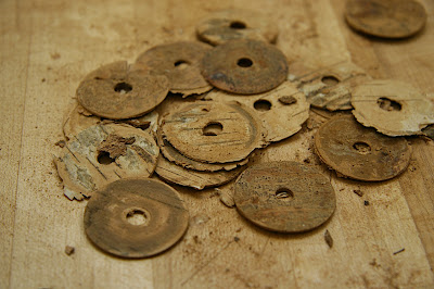

While waiting for some of my rod materials to come in, I started the process of preparing the birch bark. You’ll see that I have cut circular pieces of birch bark using a 1 1/2 inch hole saw with a 1/4 in hole in the middle.

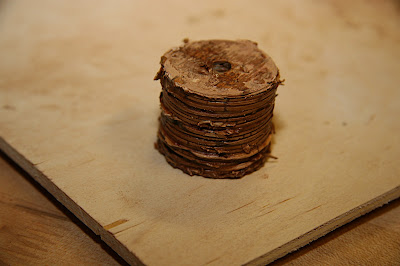

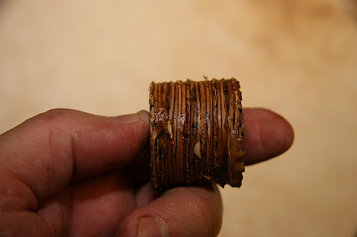

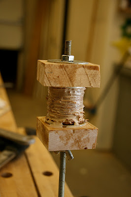

Before the glue up, I used some sand paper to clean up the surfaces…and then veneer the individual wafers together using Titebond III glue. Clamping then up using a 1/4 inch threaded rod (approximately 12 inches long), with a large washer, piece of wood (1.5×1.5) and a nut that I can tighten.
See the work in process pictures and the final glued up pieces of birch bark veneers.
