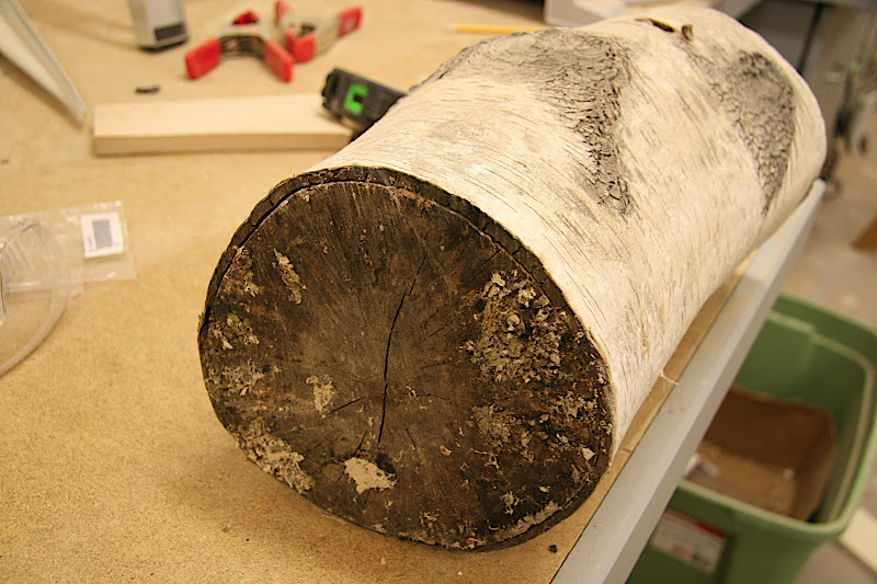

My first chore is finding some birch bark and since I live in Arizona we have plenty of cactus (i.e., saguaros) but no so much birch. I was originally going to post a question for where I can find some birch bark, but after sifting through my wood stash this morning, to my amazement, I found a birch log. Whenever I find a old piece of wood – I have to think back to where it came from (reminds me of places I have been and people I have met). And in this case, the log came from a tree that was located in front of my childhood home where my mother still lives (Lowell, MI). We had to cut down the tree after it fell in a Michigan ice storm. We did end up planting another beautiful birch tree in the same spot – it’s growing very well. I must have shipped this log from Michigan to my home in Arizona 4 years ago and after being in a hot and dry climate for a few years – it now weights about half.

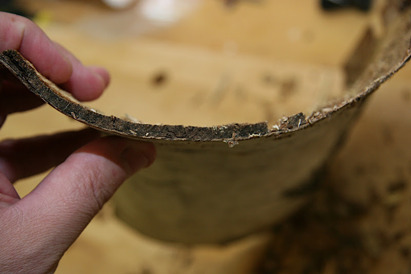

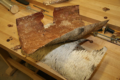

This morning, I stripped the bark off the old log and started to clean it up. I ended up wetting down the bark to see if I can flatten it without much luck. I still need to strip the layer of wood that is stuck to the bark – this will take a little time today. My goal is to get it flat enough to drill 1 1/2 inch holes (hole cutter) to be glued up for the rod grip. This is my first time doing this process but I have lots of advice from this web site (http://www.rodbuildingforum.com/) – if you’re interested in learning more yourself.

Looks like the bark that you have may not be fresh, but you may be able to save it with a scraper, try cutting it into 2” strips, let it dry, scrape the strips flat, cut into 2” squares, drill 1/4” hole in the middle of each one, glue them up on a piece of 1/4” all-thread rod, be sure to put the ‘other’ disks on the rod as you build up the handle, put the threaded rod between centers and turn it into a handle. If you are going to use an up-locking seat put the hood cork on after turning and fitting up the handle.
The site you quoted looks like the handle was turned on the rod, IMHO don’t try it… turn the handle on the threaded rod… the graphite rod blank is too flexible and may self destruct as you spin it.
After the handle is turned bore it out to fit the rod, then epoxy it to the rod, much easier in the long run.

Regarding the birch bark. I cleaned it up last night and it actually looks pretty good. Let me know what you think.
