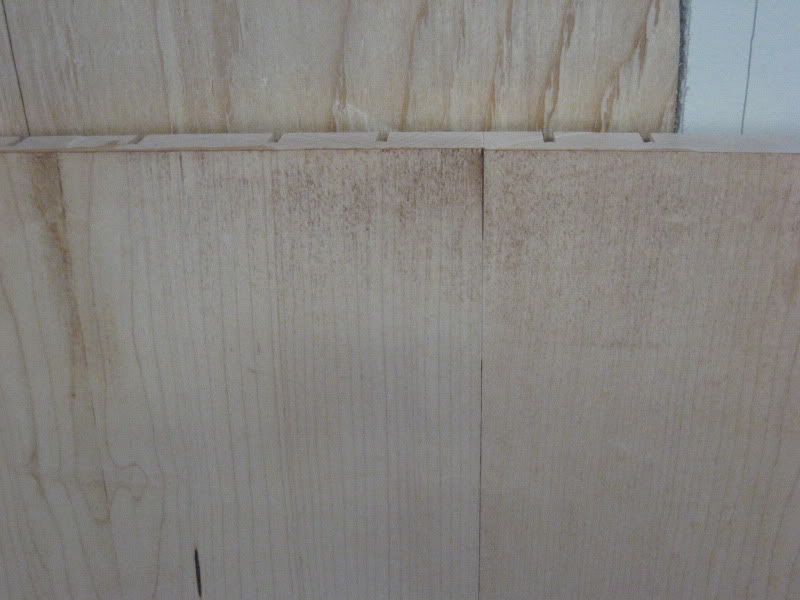

Here’s the bleeding part:
bad stain
and here’s a closer look:

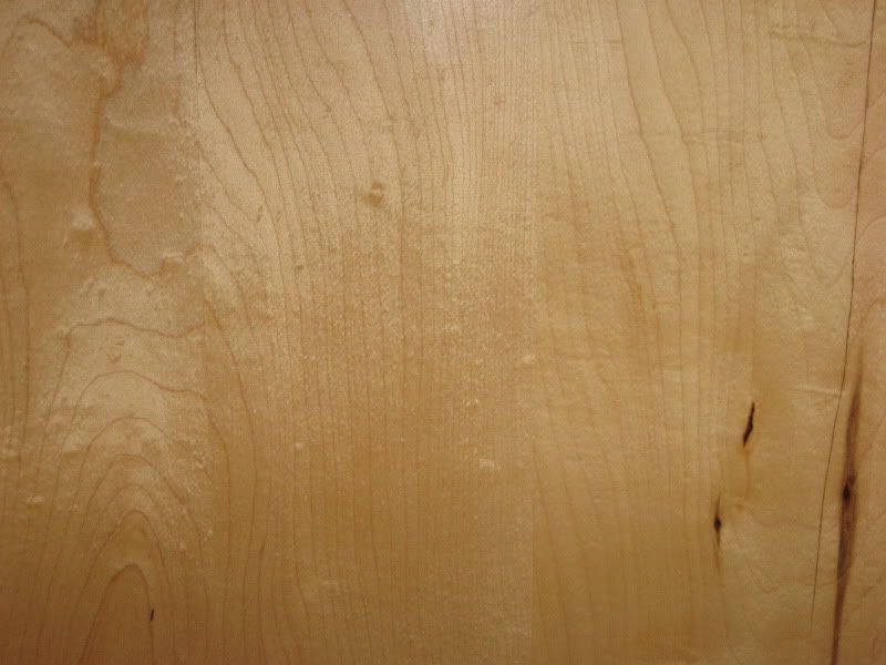

...and here’s where the stain didn’t bleed through:
good stain
http://s833.photobucket.com/albums/zz254/randman64/The%20House/?action=view&current=Breakfastbar016.jpg&newest=1

I used a spray gun to apply the shellac sealer, full 2 lb strength, three coats, and then wiped on the oil based stain.
The jury is out on how I feel about the look of it (very subtle amber, although the colour is right it is a little too glossy. I’m hoping the final coat of Varathane satin will taker ‘er down a notch)...but really, it’s time to move on.
