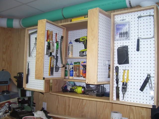

A couple of months ago, I got a great deal on a Delta 50-760 dust collector (DC). It was used but barely, and I got it for $200. I have a relatively small shop; only 8’ X 18’. Originally I planned to place it outside a shop wall, in my garage, to save on space. However, I found I could fit it in what was a “dead” corner in the shop, sort of tucked out of the way. I decided to run ductwork and thanks to the fine work of fellow LJer, Patrick Jaromin, I had a guide on which way to go. I opted for the 6” green sewer pipe with four 4” drops. There has been much discussion about reducing the drops and to avoid repetition, I will refer you to Patrick’s blog for answers to those questions. For me the biggest challenge was what to do about the junction where the ductwork breaks off in two directions. Based on the corner I selected for the DC, it was in the middle of the ductwork. We know that 90 degree tee fittings are not acceptable for dust collection systems. I found what is called a “double tee” (aka sanitary clean out) fitting. It has two sweeping 90 degree turns. Ideally it would have been 6” on the sides and 4” on the bottom. Even 6×6x6 would have been nice and I could use a reducer at the bottom but I found it is only made in 4” size. I kept searching (googling, etc.) and ultimately found that 6” to 4” adaptors are sold so I decided to go with them. I resolved that my drops were going to be 4” and since I was incorporating a pre-separator (more on that shortly), that would be 4”; I would bite the bullet and allow the ductwork to reduce to 4” just before it headed down into the separator and finally the DC.

I wanted to use as little flexible hose as possible but the separator is designed to accept a flexible hose to its side. I decided to bring the 4” ductwork right down to the separator using long sweep 90 degree elbows. The problem then would be how do I remove the trash can from the ductwork to empty it? One night when I was very tired and frustrated, I solicited the brain power of a neighbor who came up with the idea to use a 4” Fernco sleeve. After removing the lid, I just loosen one clamp and slide the trash can over to pull it out and empty it.
