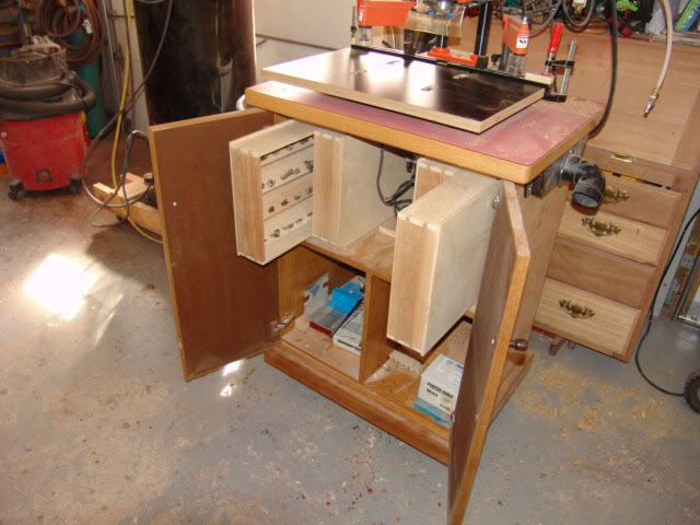

I guess about ten years ago I made a second router table for certain applications. Mostly it was to be used with Incra jigs and accessories.
This table is a little fancier than the last one I posted ands does have a few advantages.
For example there is no back to this cabinet. Both sides have the same door arrangement, so accessing the router is easier to make height adjustments.
Also there is a lot of bit storage in the four vertical pull outs. These too can be pulled out to either side so your able to access them easily.
The mounting plate was originally made from 1/4” Lexan, however there was too much flexing taking place for really accurate work. I replaced the Lexan with 1/4” aluminum plate. This is rock solid and provided the stability to do really intricate and precise work, as the Incra jigs are designed to do.

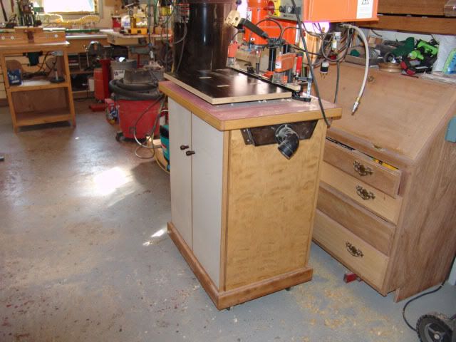

In the picture the table is sitting on a furniture dolly. Since having bought a shaper this table, like the last one is rarely used. Now it supports a Blum hinge machine, which is very heavy. Having it on wheels make it easy to move around the shop.
While this cabinet does have dust collection, and it works fairly well, it’s not as effective as the one on the other table.
By the way, the laminate was left over from a job. (I don’t want anyone thinking I bought this color for a router table)

The pull out bit storage is pretty handy.
One side of the cabinet is 1/2 ” shanks, the other 1/4”. Actually only one of the four is 1/4”.
It is convenient though.

Looking at the pictures now, I see I took pictures of the back of the cabinet. The aluminum plate is closer to the front edge, leaving enough room for the other fence system, if I wanted to add it to this table.
I would probably add some sliding shelves or drawers in the lower section too.

Hi Lee:
How is it for bit changes? Mine has a plastic insert ( lee Valley style) to reach the collet nut from up top.
Is that a Porter Cable inside?
3710 posts in 873 days
posted 509 days ago
Hi Bob;
Yes it’s a Porter Cable hiding in there. I kept the hole in the aluminum plate small so tiny pieces could be routed without worry of them tipping when they were over the bit. ( I hate it when that happens).
With the other router table there was no need for a large opening in this top.
This unit was dedicated to intricate work, so no large bits would ever be used.
Changing the bit is pretty simple since the motor drops from the housing easily.

Thats the coolest looking router table I have seen. Very nice with the pullouts and the figured wood on the side is a nice touch. A lot better than just plywood!!!
