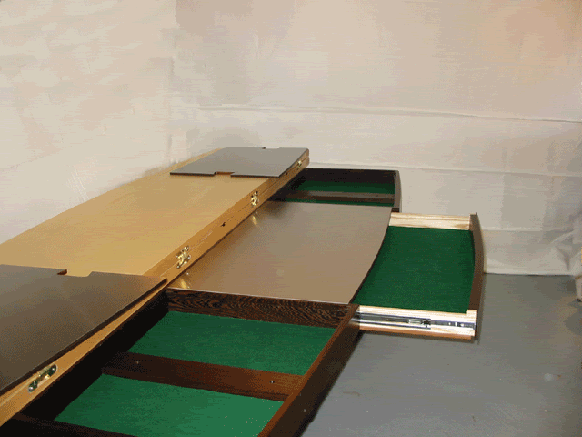

We built the trestle style leg sets, and the main frame of the table with wenge. The top was constructed with a resin coated honeycomb cardboard core, covered with M.D.F., and book matched ash veneer.
The top consisted of two pieces, joined at the middle with saus hinges. One half of the table flipped over onto it’s counterpart, exposing the brushed stainless steel work surface. The stainless is actually laminated to a wilson- art plastic laminate. (like formica).
The work area under the stainless had a center drawer, covered with felt, as well as two sections that lifted out, for tool storage, at bothends of the table. These too, were covered with felt.
Since the gentleman was not a young fellow, or in the best of health, the table had to be light enough for him to open and close. The honeycomb was the perfect solution.
We inlaid “butterflies” into the top to mimick the ones used by Nakashima to repair cracks in his slab lumber tables.

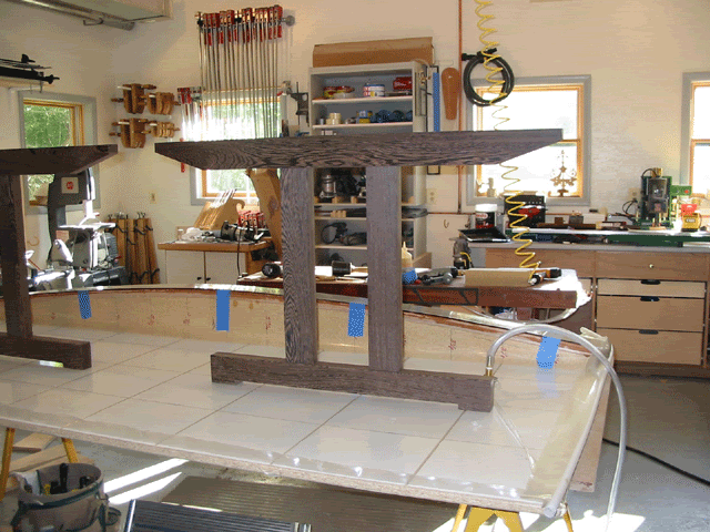

Lee great design. A unique use of internal space. I guess the laminate doesn’tcome off over the drawer.
It looked like you bent the Wedge as you were glueing up the table frame. How did you keep the curve when you cut out the drawer?

Actually, we used 3/8” bendy board, and 3/8” thick wenge, and curved them over a form. This was placed in the vacuum bag, so when the uni bond 800 (urea resin) was cured, the curve remained. Check the bottom photo and you’ll see the form in the bag, with one of the aprons on it.
Then dado’s were cut into the apron at the desired intervals, for the cross pieces. Cuting the drawer face was done with a hand saw, held on the desired angles, so it wouldnt show a gap too much when closed. The curved stayed fairly well. The bottom is glued to the center of the front and rear, which helps to keep it in place.
The clamps were used to press the dado’s tight onto the cross pieces, as they relaxed somewhat after being dadoed.
The lanimnate above the drawer isn’t removable. The thinking here was if he had his computer dismanteled, he wouldn’t have access to the space below.
