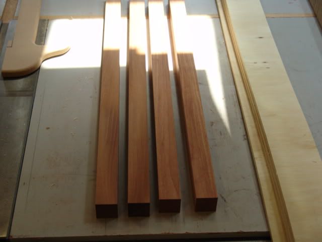

This one has a crotch Mahogany Top, with solid Mahogany legs. The legs have a little detail, just to spice them up a bit. I used a jig to cut the cove in the leg bottoms, and to cut dado’s in for a bead molding. While a dado blade in the table saw would work for the dado’s, it wouldn’t do the cove. So, I used a simple jig to do both.

Mahogany Table Legs
