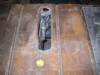

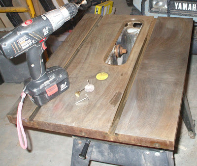

Well, I spent last evening trying to remove the rust from my table saw. It’s much harder than I expected. I tried WD-40, BD Wells Rust Remover, Engine Gunk Remover, and some all-natural super-cleaner my wife had. The thing that worked best was some very fine metal sandpaper. I was careful not to sand too much and ruin the top of the table. I’m still prob. only 1/2 way there, but I’m making progress.
Before:
Before
Before – Closer:
Before
After:
After

Looks like fun.
I usually just take my sander to the top (evenly) and then wax up the metal after it is nice and shiny.

Looks like an old Craftsman… try a wirebrush and CLR. Let the CLR sit a while, use a wirebrush to work it in. Wear rubber gloves.

I always use wet/dry sand paper on an old sander that I do not intend to use on wood anymore. I start with emry cloth and work my way down to 400 grit and spray WD-40 on the area I am working. It has worked every time. You are making progress: keep it up.

if it’s not too pitted try Naval Jelly used it will success quite a few times now.
