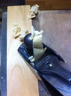

As requested, some shavings-
Woodwork, Uploaded from the Photobucket iPhone App
Here is the board (English cherry) after a few passes-

We like to see the shavings John. Nice bit is Cherry too.
