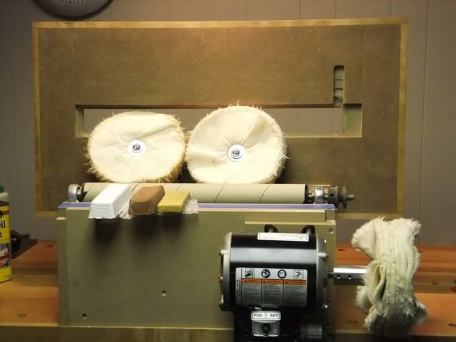

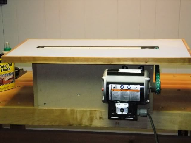

VDrum mode:
Beal Buffer Mode:
Steve

That’s a really cool set up, how does the vertical drum work. Where does the down pressure come from? If all that was about $70, I might see one in my not to distant future. Thanks for sharing with us Steve. I am sure you are getting some nice finishes out of it.
-- JoeyG ~~~ http://www.facebook.com/JHGWoodWorks
View SPalm's profile
SPalm
4108 posts in 2051 days
#11 posted 499 days ago
The horizontal drum? It is a Vdrum sander. It works like an abrasive jointer. You apply human pressure. It has nothing to do with the buffer other than I am borrowing its motor. The $70 just buys the 3 buffer wheels, the 3 bars (tripoli, white diamond, wax), and the aluminum motor coupling.
