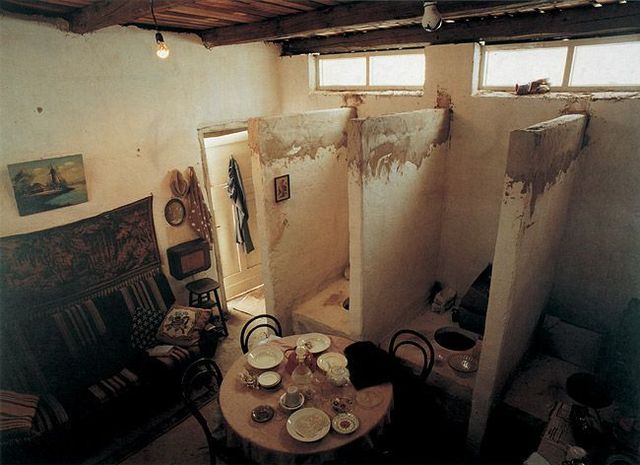

14915 posts in 744 days
posted 178 days ago
Thats an idea Dan. No door at all.
Sign on dunny door Pictures, Images and Photos
posted 178 days ago
toilet door Pictures, Images and Photos
