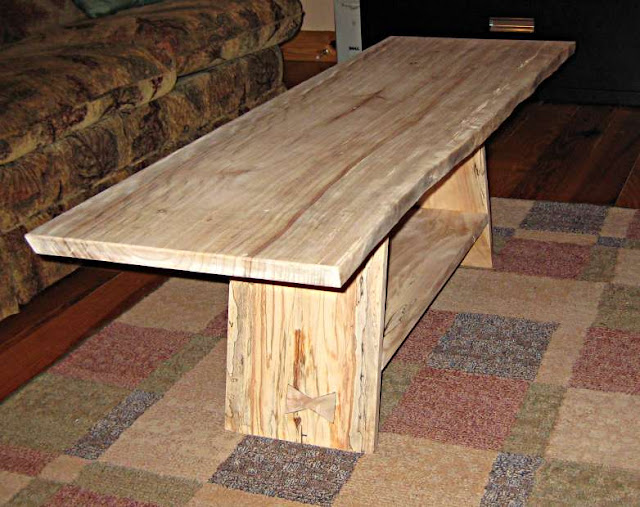

So, given I had a nice slab of Florida camphor about 5/4 thick with a natural edge and some slabs of
highly spalted quartersawn sycamore—these were growing white mold on ‘em—what could I produce?
The result is the table seen here:
The table is unfinished as it lacks a finish. Moreover, the base is complete to a point.
The shelf is joined to the legs with a stub mortise and tenon. Period. Glued M&T and nothing else.
As is, it’s stable but there’s no racking strength in this design and I’m trying to decide how I want to do
the aprons such that I eliminate the table base blowing out over time (through use) while minimizing the
apron’s impact on the visual clean lines of the table.
So, there’s the question: how would you make the apron?

An interesting table. As for the aprons, I’m not sure I’d put aprons on it. Instead, I might put a single support piece (trestle?) right under the top and the shelf. As long as the supports are not too wide (more than 2 inches), they should not distract from the visual interest, and I think they should give you what you’re looking for structurally.

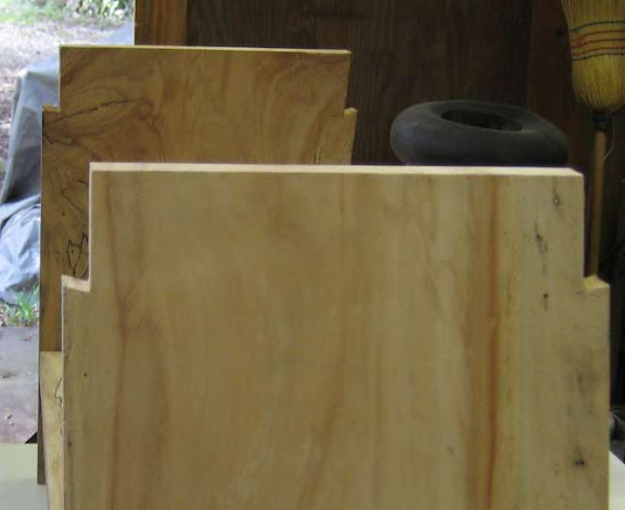

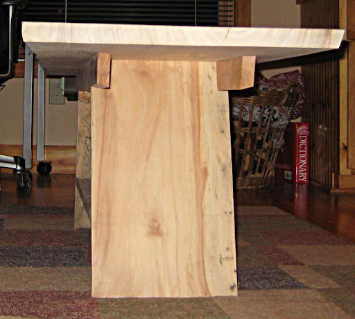

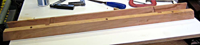

I decided to run two narrow aprons along the long side of the table.
The aprons have dadoes which form a half-lap joint with rebates cut into the top of each leg
such that the leg and apron are in one plane, maintaining the clean line of the preliminary base.
I uploaded new photos to the Picasa album. Here are the key shots:
Rebate for aprons
Aprons
Legs and aprons
Table
