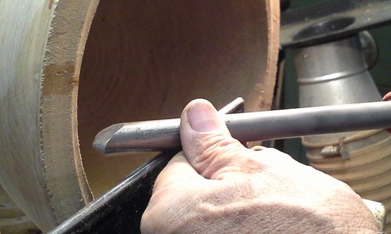

Thanks, L/W, I hope I live that long, LOL! I love to teach (started at age 14, tutoring a neighbor's kid in music), but it's hard to imagine right now teaching turning. I now have two Turning Teaching Heroes-Bonnie Klein and Mr. Mentor from yesterday. Bonnie is just flat fabulous, took a 2-day workshop from her years ago. Yesterday, I was impressed with how Mr. Mentor could, when I was having trouble, just take the end of the gouge between thumb and finger and guide it while I was still holding the tool. Gave me a great reference feel for how the tool should feel as it approached and cut the wood.

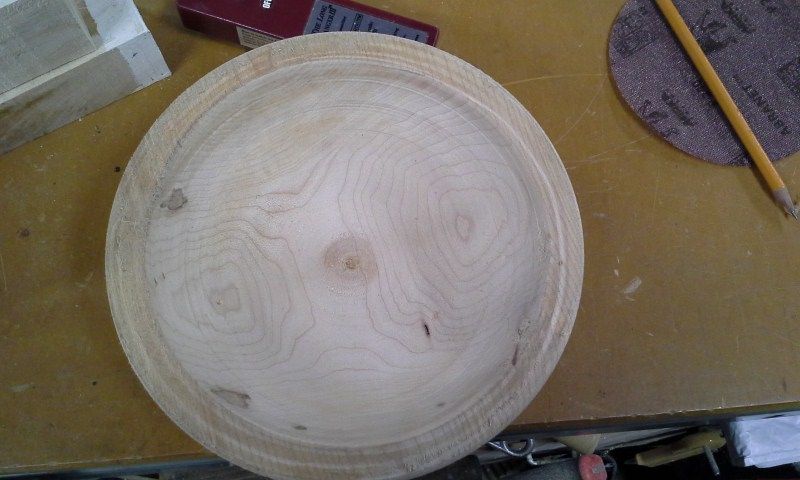

Pictures. Bowl is Big Leaf Maple from near our house, turned green ages ago, almost finished yesterday. The bowl after my spate of catches (several days ago):
Here is Mr. Mentor demonstrating the approach that was giving me trouble. Love the Robust tool rest!

Here's the almost-done bowl. The pencil line on the interior is an slightly raised area that need a touch-up with the scraper.
The rim is not as proportionally big as it looks in the picture. It's 1/3 the height of the bowl.
