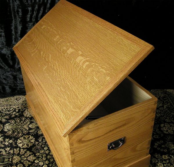

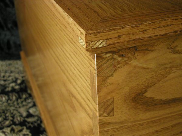

I recently finished a dovetailed blanket chest as a wedding gift for my good friend. I think it came out pretty nice.
I was able to get it into his house while he was away on his honeymoon. He and his new bride really loved it! It’s a great feeling knowing that they will have this gift and cherish it forever.
I made a video about the entire process.
Here’s a link to the video. Check it out, and leave a comment telling me what you think:
http://www.eaglelakewoodworking.com/post/Oak-Blanket-Chest.aspx
Oak Blanket Chest
Oak Blanket Chest 2
Oak Blanket Chest 3
