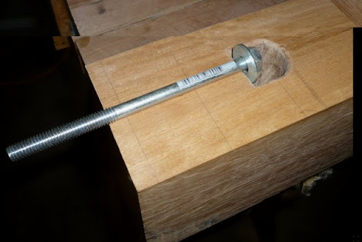

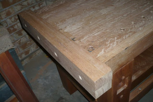

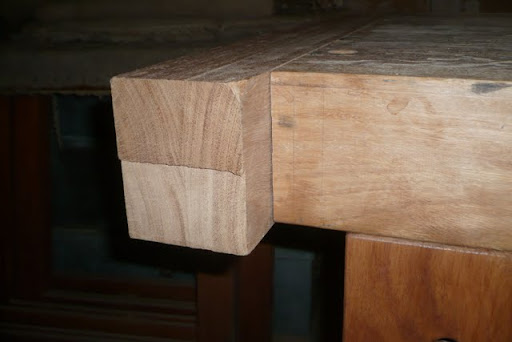

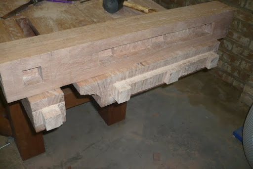

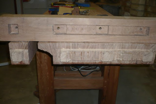

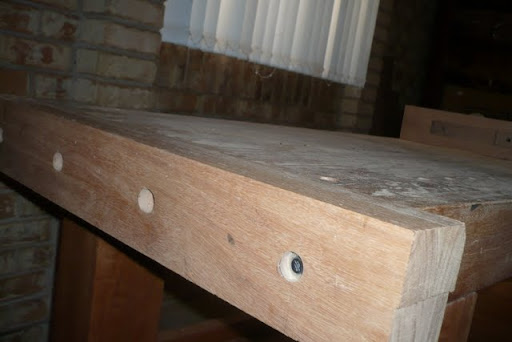

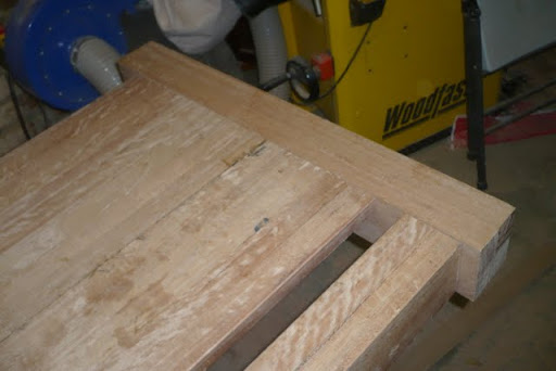

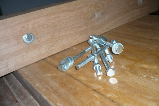

So there are two end caps. I made them a while ago. Laminated two pieces of wood. Drilled the bulk of it on the drill press. Tidied it with router and chisels. They will be attached with slotted bolts and captured nuts.
End Cap 1.
End Cap 2.
Unfortunately end cap 2 is not up to standard. It is is about 2-3 degrees out. Which means it is not accurate enough for the wagon vice. The solution, which will have to wait, is a straight edge and a router. However, as I’m seem waiting on my Vesper Tools square… I shall wait for that.

Looks like your almost there. I was wondering how you are going to allow for wood movement with you end caps.
View DoctorDan's profile
DoctorDan
281 posts in 1212 days
#2 posted 1109 days ago
The tenons are over sized about 1/4” laterally. The holes are slotted a similar extent.
