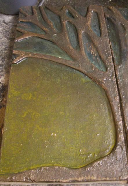

This process went pretty quick.
I started at 6pm and now it is 10:30.
Includes all the photo editing and the whole nine yards.
added bronze coating and let dry about an hour. used the stuff on far right.
bronzed 6 panel
patina acid materials
panel after 15 minutes of acid soak
panel after 2 hours … ready to get started
beartex -............... rub really-really hard, long-long time
after beartex rubbing
clean off surface with brush and spray on several coats of gloss lacquer
let dry with fan blowing on it
spray coat of matte varnish
done !!
cool little detail
the tiles ....

Frame is not started yet.
Did measure all the tiles. 5.25 wide x 10.5 tall.
Thinking of greene and greene design, but never know where it will end up
