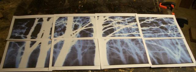

This is a new technique I wanted to try. Previous projects, I have tried the drawn on technique as well as carbon paper. Thought of using a projector or finding a large format print shop, but searched the internet and found the technique of breaking part a photo into pieces call ”poster printing”. Looked at several and sellected a shareware program “Mr. Poster”. Program has it’s limitations, namely limited to it’s default size settings, ie, number rows and columns rather then a specific size (45×16 etc) , but it fit my needs. It was free, didn’t print out watermarks, XP compatable and it is easy.

#1 posted 10-13-2007 11:05 PM
printed this out on draft settings so as to not use much ink

#2 posted 10-14-2007 01:31 AM
DAn,
It looks like it will work. I am assuming from what you’ve said that you want to use this as a pattern to transfer? It really is effective as a poster.

#3 posted 10-14-2007 01:41 AM
Hello Tom
My plan is to glue this to the top of the wood. Color code what I can and use a router to rough-out different levels, not sure how man levels yet. Probably around six or so.

#10 posted 10-15-2007 02:18 AM
Thanks for the comments. I’m finishing the frame today. Also depth colorcoding the poster for this tile project.
I’ve got about 3 hours into the colorcoding … basically watched the Cowboy game and colored the poster. The colors will be used to controlled the router hog-out-depths in the mahogany.
Red, Green, Magenta, yellow and black. Four levels. Will post a photo of the colored poster when done.

#12 posted 10-15-2007 06:12 AM
Done with the color coding of the poster. Will glue it to the mahogany and start another blog when it is ready for the router…
View Dan'um Style's profile
Dan'um Style
14171 posts in 3858 days
#13 posted 10-15-2007 06:17 AM
The background trees that are grey will be treated the same as yellow.
Black will be the deepest.
Yellow will be 1/8 inch above the black.
Magenta will be 1/8 higher.
Green will be 1/8 more
Red will be the top level.
