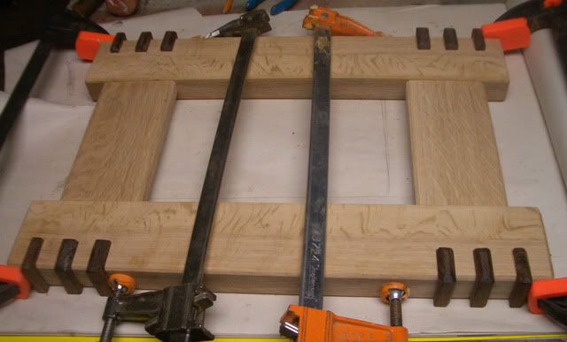

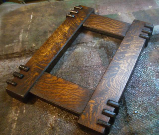

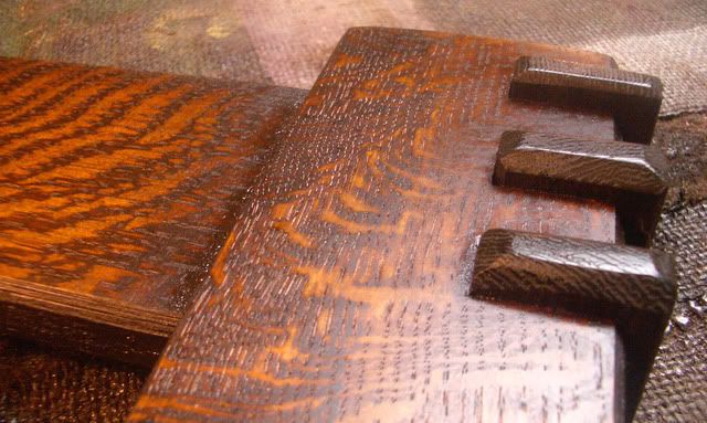

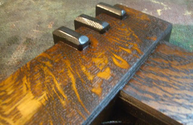

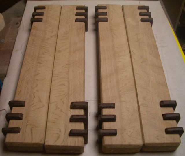

book-matched, glued,clamped, sanded, dark golden oak dyed and minwax mahogany oil stained.
next steps are spray lacquer, seedlac and paste wax … stay tuned

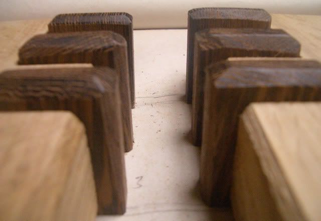

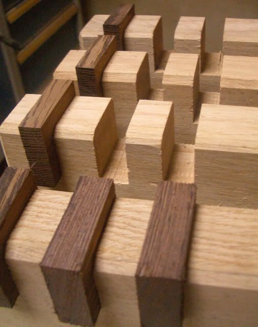

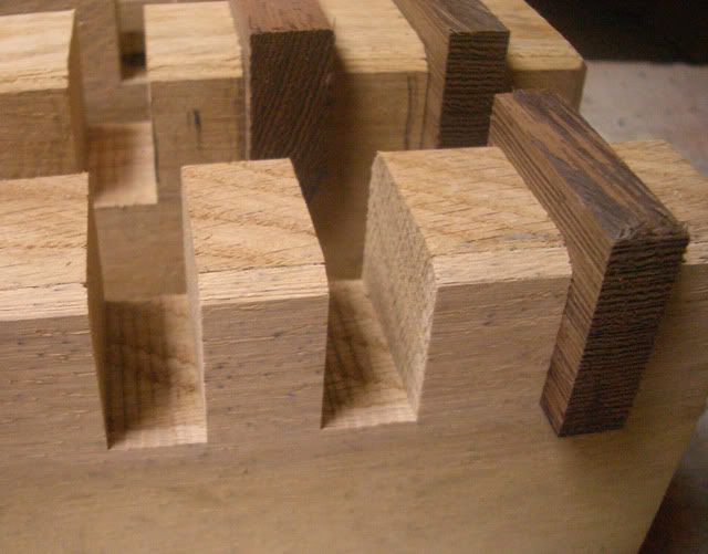

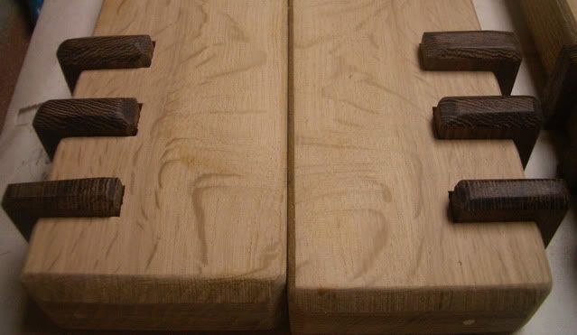

thanks guys … if you look real close on the 6th 7th 8th photos you can notice the brass rod drilled and installed to lock in the wenge details …

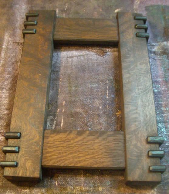

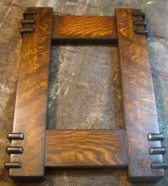

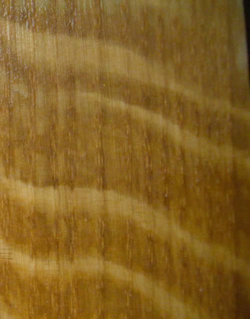

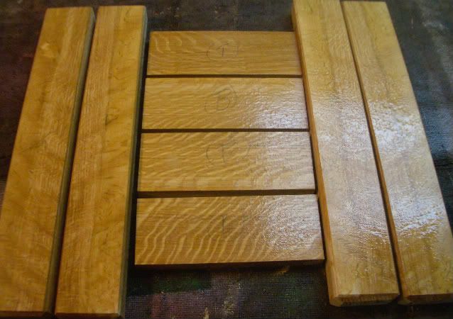

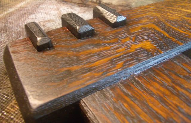

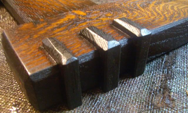

on the finish … up to this point,.... the oak was sanded to 180 on the face side and 24 grit on the sides and chamfers.
The wenge sanded to 400 on the ends.
very dark …stiff…dark golden oak alcohol dye stain… Liberon’s Brand
.applied with an old brush and wiped off with a red shop towel. Rubber gloves.
... about an hour later …
Japanese dryer jazzed-up Minwax red mahogany oil based stain. Highlight the flakes by rubbing off the oak dye, with very fine scotch brite. Feathering as you go. work fast, do not rub too hard in one spot….
Rub the oil stain around …leave it dark in the corners,do not over do it. Wipe off the stain
with red rag …and that’s where these photos leave off.
watch for the next in the series …next weekend! or maybe sooner … ... frames will be sprayed with lacquer, rubbed with seedlac shellac and then Briwax ,,,
