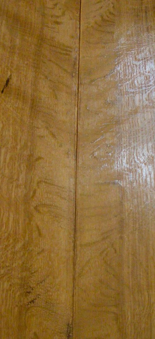

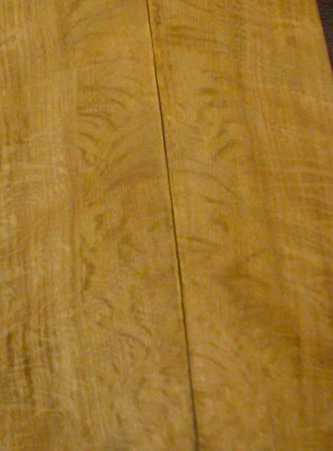

not much of a story on making the veneer. I set my fence at .1875 and cut four thick veneers from a 1 inch thick board using a thin kerf blade, raising the blade a 1/2 inch or so at a time until it was at maximum height. After doing the side cuts, I lowered the blade and cut thru the center of the board, raising the blade a little at a time. When all three cuts are done I ripped the veneer off the 6 inch wide board as shown. A better startingnumber, would have been .156 ,but for what I’m doing, the .187 worked ok…. plan is to glue the thick veneer to some less figured quartersawn oak anyway.
below are the photos. Oak is as cut with a little lacquer thinner to highlight the figure a little for the photos.
Had this piece of wood for years …waiting for the right set of frames.
