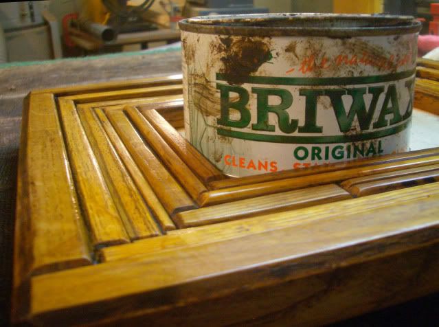

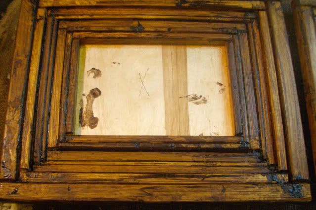

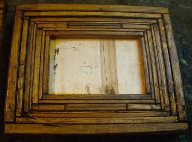

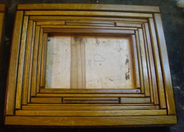

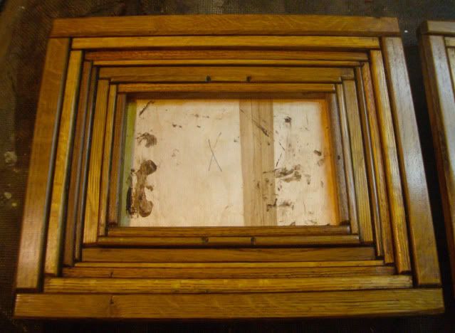

frame is brad nailed and glued quartersawn white oak with a couple layers of quartersawn zebrawood to add a little interest.Wood is sanded to 220 grit. Finish is a coat of spay lacquer, sanded to 400 grit and then followed by a couple coats of brushed on seedlac shellac.

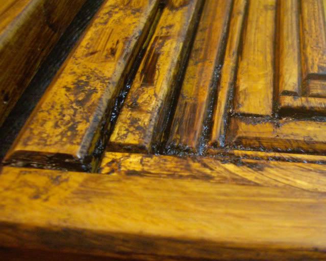

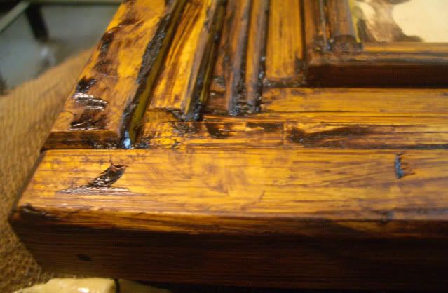

Glazing with dark wax took the piece to the next level. Wax was wet sanded into the shellac with very fine scotch brite.

That is a beautiful finish. I have become a big believer in using wax and was wondering what is the process of “Wax was wet sanded into the shellac”? Thanks

the trick is to sand the chamfers with course sandpaper … I used 24 grit in 80” my edge sander before the motor went a couple days ago.
