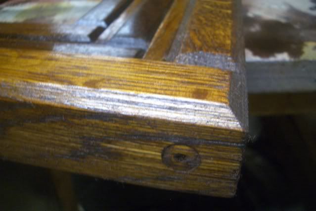

TILE WAITING FOR A FRAME #4: walnut oak frame alcohol dye and oil stained
Blog entry by Dan'um Style posted 10-01-2009 03:24 AM 1313 reads 2 times favorited 14 comments Add to Favorites Watch
« Part 3: more wood and a photo of 24 grit 6x80 2 hp edge sander ... great chamfer tool Part 4 of TILE WAITING FOR A FRAME series Part 5: shellac Lacquer wax clamped glued »

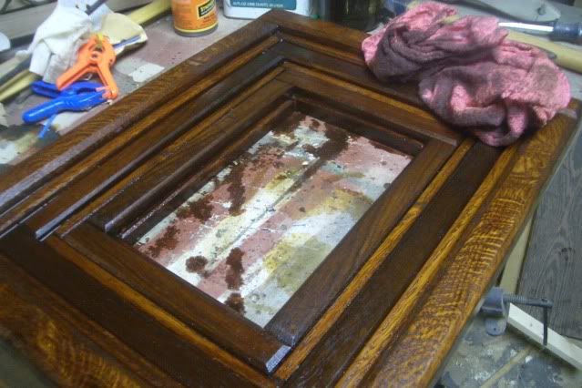

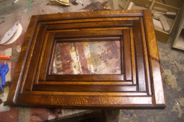

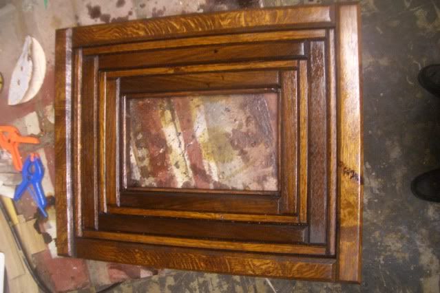

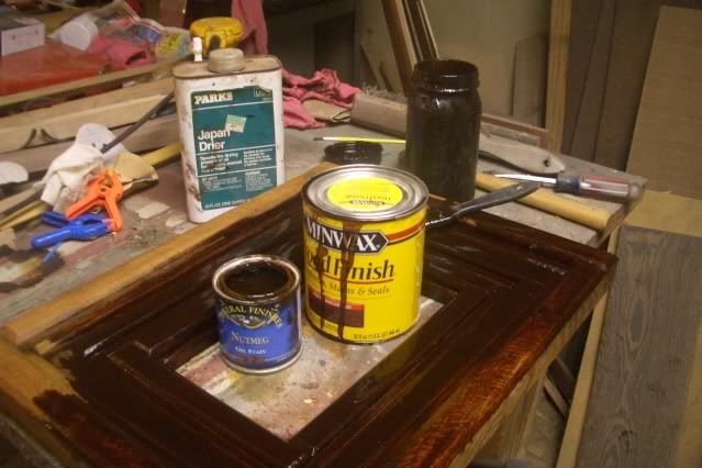

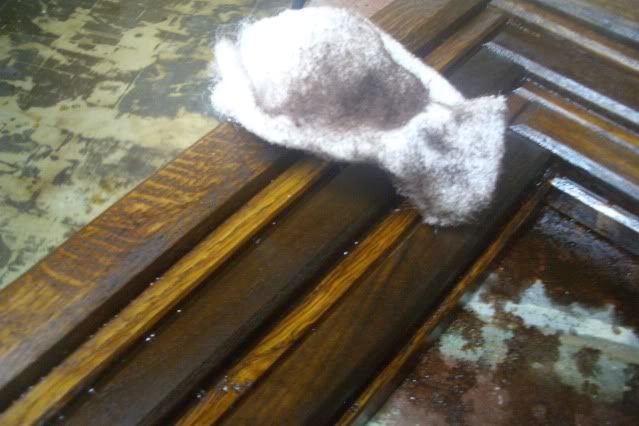

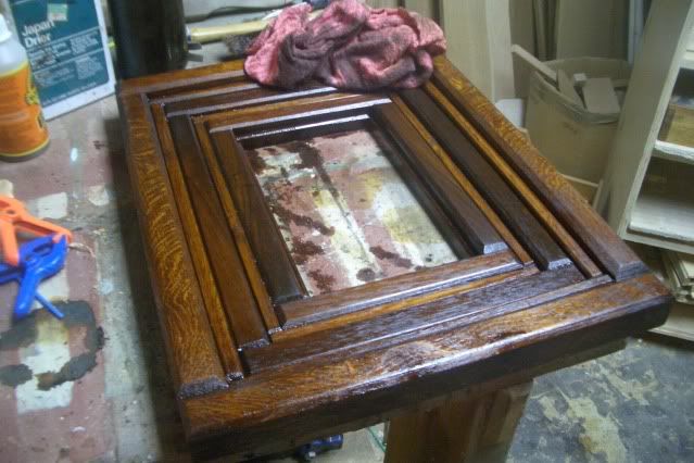

really jazzed up oil stain. dry in about an hour
couple hours later …

#1 posted 10-01-2009 03:44 AM
Wow, looking Great Dan! Love the richness and warmth of the tones…

#2 posted 10-01-2009 03:48 AM
walnut and oak look great together… that is some of my famous MLK Memphis Tennessee black walnut.

#3 posted 10-01-2009 03:50 AM
Dan frame is looking fantastic.

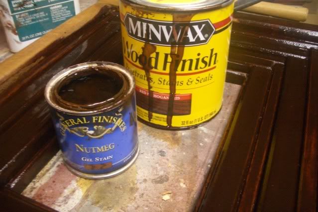

I am curious, how does the Japan Drier work, how much time does it cut off?
Rob
-- Whether You Think You Can or You Think You Can't, YOU ARE RIGHT!!!
View Dan'um Style's profile
Dan'um Style
14171 posts in 3886 days
#4 posted 10-01-2009 03:56 AM
I’ve been using Japan dryer for many years and have saved dozens of hours of wait time. I would guess it is ready to put a coat of shellac in a few hours. It is dry to the touch in less then 2 hours. Will put a spit spray coat and let it sit overnight.

#6 posted 10-01-2009 04:13 AM

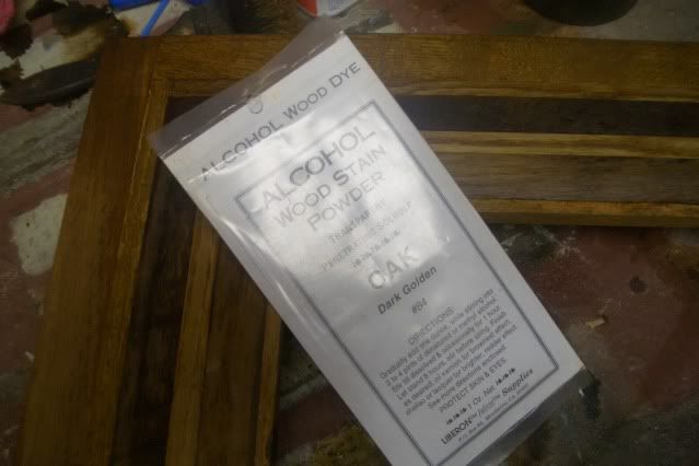

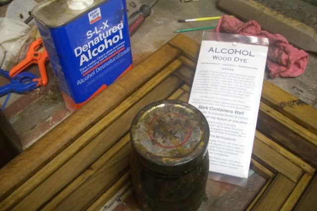

Dan, That is going to look great. If I may ask what are the proportions on the dye mix and do you mix the nutmeg and red mahogany stain together or put them on separately and in which order? Or is it all mixed together and then applied…. I hope this isn’t a trade secret….
Dan'um Style
#7 posted 10-01-2009 04:24 AM

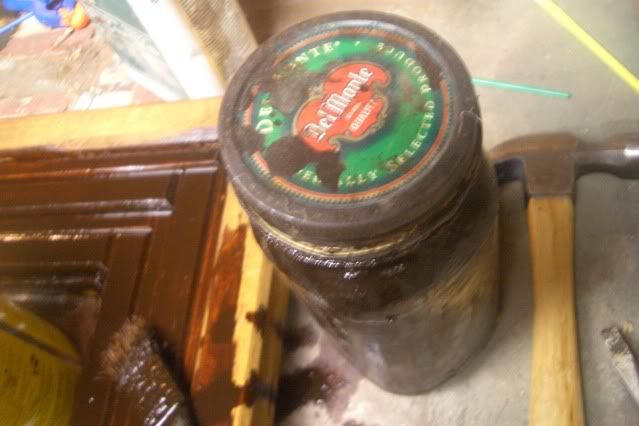

no secrets here …. I mix the oil stain in the jar…. about a half a can of gel stain and 1/3 can of mahogany and big ole splash of dryer. Put it on quick or it will start to dry. Keep it wet and rag it off.
View Max's profile
Max
56000 posts in 4176 days
#8 posted 10-01-2009 04:26 AM
Thanks Dan…. What is the mix on the alcohol dye and do you put that on first? I am just full of questions…
Dan'um Style
#9 posted 10-01-2009 04:36 AM

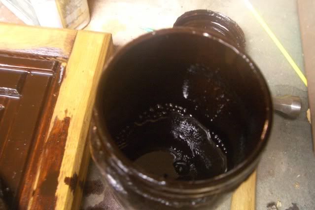

mix the dye so it looks like really dark ink. it really varies. Actually the ratio was a little light on this jar.

#13 posted 10-01-2009 05:33 AM
So is the dye mixed separate or in with the oil stains?
