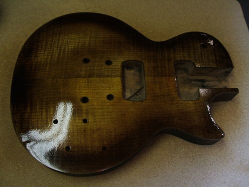

Update:
I have wiped the alcohol-based aniline dyes to the body… pretty dull because no clear coats yet. I started with black, then sanded back to wood… leaving just hints of black in the stripes. Then amber/yellow over the whole top, then tobacco brown around the edges, and finally amber and plenty of DNA to blend, shape and even.
One coat of clear nitrocellulose lacquer sprayed…
After two coats…
Third coat…
-- If you're going to stir the pot, think BIG spoon or SMALL boat paddle. David Grimes, Georgia

Update:
Now six coats on the front…
First coat on the back…
BTW, I’m loving how the nitro lacquer burns into previous coats instead of adding layers like urethane. Also, naptha will not dissolve it (that’s a good thing because I use the Naptha to wipe over blends / touchups to see how it will look. Also, since the aniline dye is DNA alcohol based, it is a great thing that the nitro lacquer is dissolved by DNA (de-natured alcohol).
My first base coat was too yellow to my liking even after I sprayed a first nitro coat. I just wiped it all back off with DNA and started over with more amber/brown and no yellow. Now THAT is forgiveness !
This is very much like dealing with shellac in many ways.
