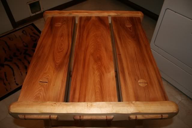

Thanks for the pictorial and step by step process. What kind of wood it that? It has a really nice grain pattern. Looking forward to the rest of the process and completion.

Os:
That’s Bald Cypress. I really like it, plus it lasts a long time outdoors. Here’s a picture of the top with the first coat of tung oil….....Table Top w/ tung Oil
I’ll try to finish this thing up tomorrow. Thanks for looking, Carl.
