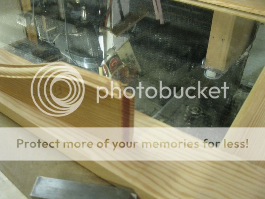

Another head-scratcher for me in the design; I’m using some existing glass shelves (I knew they’d come in handy), that are 20 5/8” W x 4” D x 3/16” H. I’m thinking of cutting horizontal slots in the sidewall of the box for the shelves. I’m not a big fan of pegs for glass shelves. The mirror is 16” W x 27 7/8” H. I’ll post pics.
I seem to have a big woodpile, but there’s always something making that piece not quite right. Hopefully I’m posting the picture correctly.
Medicine Cabinet 1
Woo Hoo it worked!
