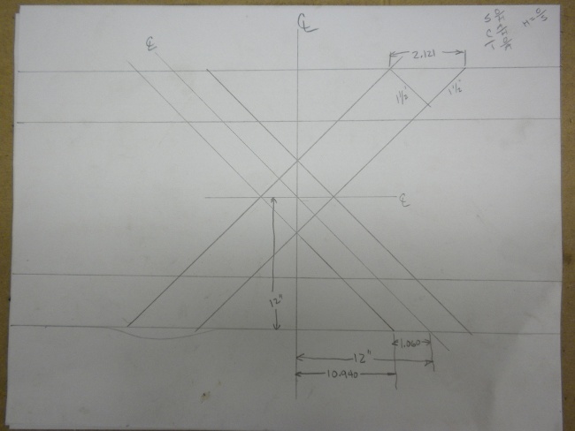

One of the issues was to cut the dadoes for the lap joints for the X brace in the right places in the top and bottom rails so that when assembled the X brace boards would line up. Using a bit of trigonometry I calculated off of center where the dadoes should be then set up stops and cut two boards and prayed. I did a dry fit with those two top and bottom rails and low and behold it looked like I got things right.

Here’s my rough sketch, not to scale of course, was surprised I got it right the first time, Murphy must be on vacation.
