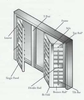

How about a shutter system were each set of window would have 2 panels that can slide away to be open.Lots of work but with the right wood your rustic look would be reached and you wont have to worry about trims.The frame would fill in the 4 ” gaps.
a href=”http://s603.photobucket.com/albums/tt115/traumajacques/?action=view&current=grashutters.jpg” target=”blank”>Photobucket
Just an idea. Nice work by the way.
-- All bleeding will eventually stop.

The shutter idea is kind of intriguing – as I will have to do some sort of shade for it. But I think they will be in the way.
