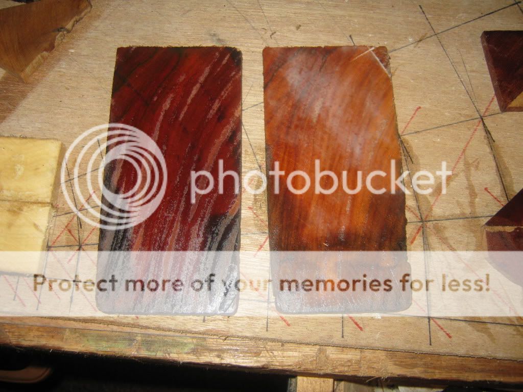

Herebelow is the experiment I made with same sample of 3 wood. The darker sample was not coated with glue.
Just to let everybody see the comparative sealing effect have following photos.
NARRA … endgrain and red orange
narra
the lighter one has glue on it… the finish is sprayed gloss lacquer.
THE MOLAVE
molave
THE PADUAK (Malaysian) and MAKOPA (local fruit tree in the Philippines)
combi paduak and makopa
Note the portion in joint where a smudge of glue really showed it is whiter than the portion not coated with glue.
