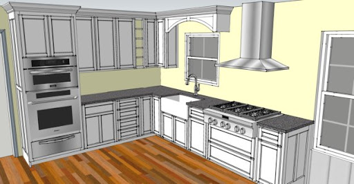

I still need to work on the tall storage cabinet and fridge cabinet, but here’s a preliminary shot of what I hope this will look like:

I need to do this too, but not until next year or later. Nice illustration, and an ambitious project. How long do you think it will take to complete?

Ah, I have been plotting mine for 2 years now. It’s such an endeavour. The sketch looks great. For those corner pieces you might want to try swing out doors. I get so tired of reaching way into the back of my current ones.

Be cautious of swing out doors and the hinge construction, my Parents had custom cabinets built and they probably have 6-8 swing out doors, and all of them have ripped the hinges out multiple times due to the weight on the end of the cabinet.
Looks like it will be great!
Have you ever considered having the doors manufactured? I know most every cabinet guy in my local area has a door place do their doors for them, time, money and consistency all being factored into the mix.
