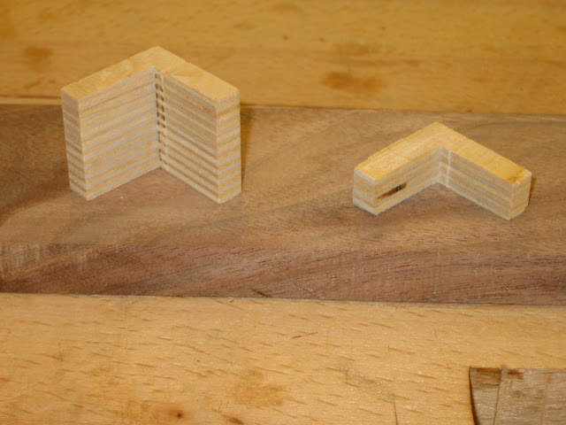

Even though you’re sticking with finger/dovetail joints for aesthetics, I thought I should clarify one thing, in case you use it in the future:
The “L” tenon is usually made of plywood (baltic birch if available), stacked up into a long length of plies, then cut into L’s, or can be of your own tiny finger joint making. This gives you the strength of a good finger joint with the look of a miter.
L tenons from baltic birch
These are the cutoffs from a batch of L tenons I recently used in a mitered case.
-b

wow, that’s really cool ben. i havent come across that anywhere yet, and it seems so easy to do. i think i will definitely be using these in the future. thanks!
