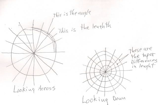

i have made 2 of these over the years ,
mark out the circle ,
and do your ( ? gon # of sides ) .
the angle between them is your cut angle ,
then you have to taper them from the middle ,
to a point ,
like an orange peel from a slice
you make strips with the angle ,
then tilt the bandsaw fence to that angle ,
and set miter gage to the angle of taper ,
for each row , ( remember there are 2 of each row ,
top and bottom ,you have to set a stop for the width of each taper ,
and change the miter guide as you go to new row ,
you can flip the strip and cut successive parts .
i hope this helps , p.m. if you have any questions .
